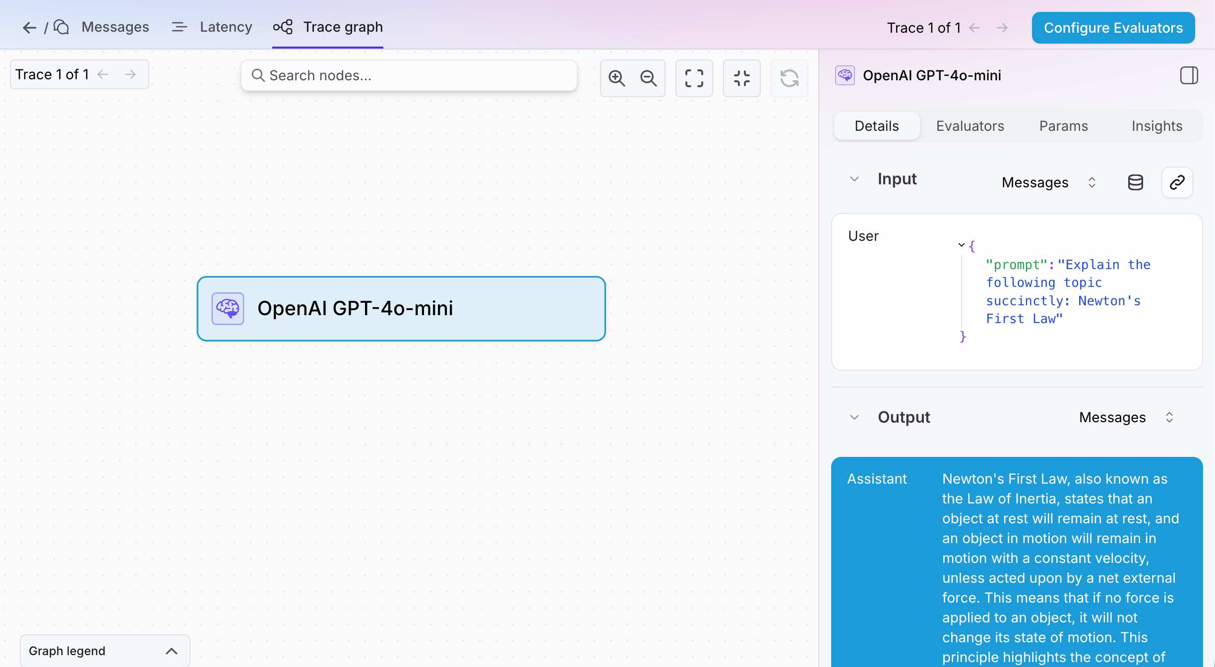

View the logged trace
From your Splunk Agent Observability homepage, open the Agent Stream for your project. You will see a trace with a single span containing the logged function call.Select the trace to see a detailed view:A trace with an input, OpenAI span, and an outputSelect the OpenAI span, then select the Evaluators tab to see the latency.
