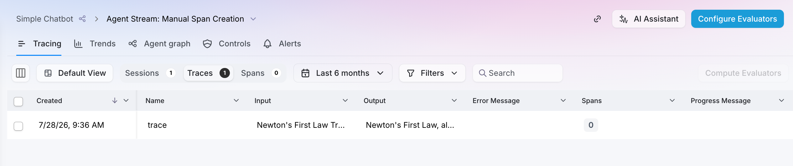

From your Splunk Agent Observability homepage, open the Agent Stream for your project. You will see a trace in the traces table.A trace in a table showing the input and output

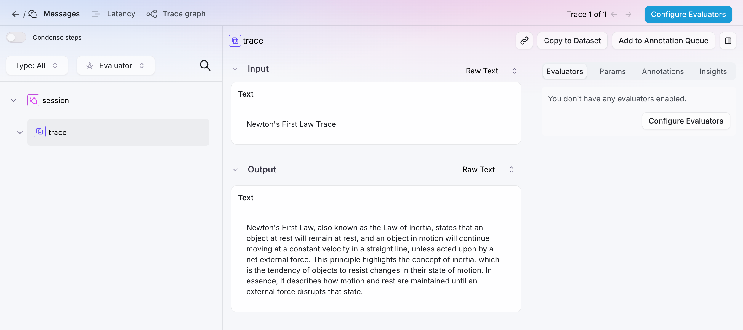

Select the trace to view details. Currently it contains no spans, and shows the question and the LLM response as input and output.A trace details showing no spans

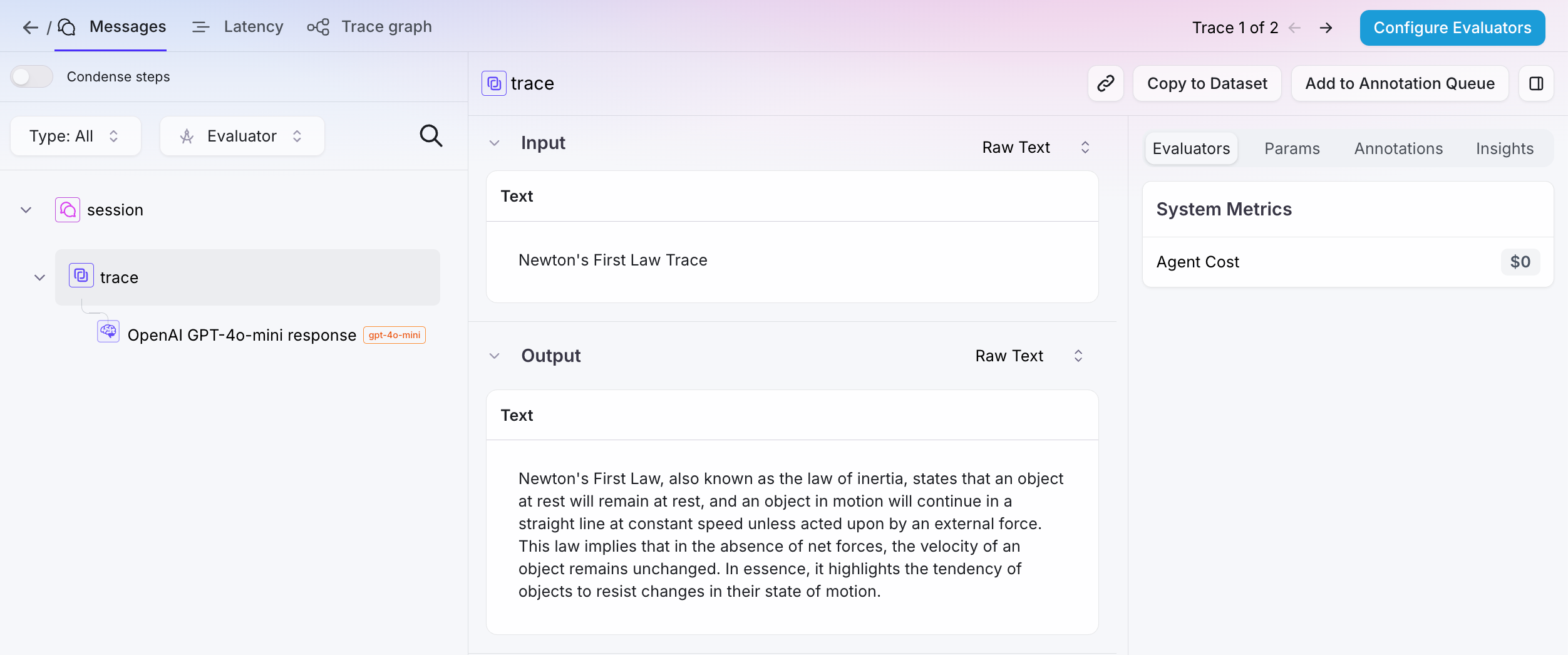

Select the new trace to view details. You will see a single LLM span called “OpenAI GPT-4o-mini response”.A trace details showing an LLM span

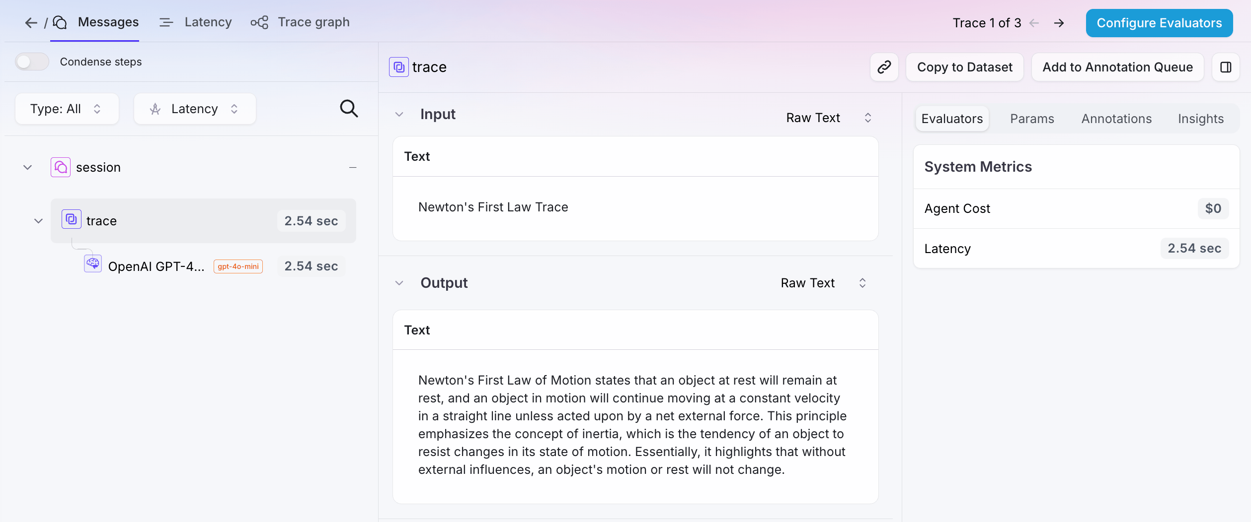

Select the new trace to view details. In the Evaluators tab you will see the latency.A trace details showing a latency of 1.43 secondsYou can select the LLM span to see more details for that span.
