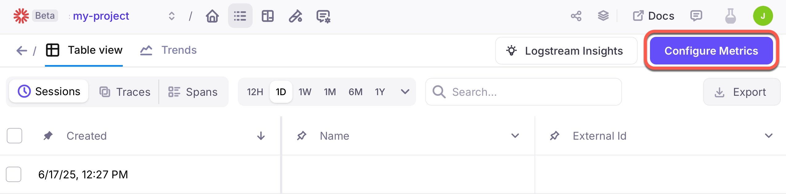

Configure Evaluators for the Agent Stream
Select the Configure evaluators button.The configure evaluators button on the sessions tab

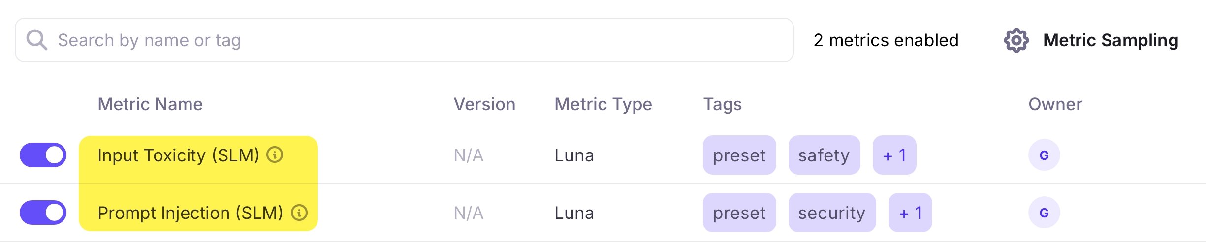

Turn on the Luna-3 input toxicity and prompt injection Evaluators

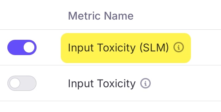

Locate the Input Toxicity (SLM) and Prompt Injection (SLM) evaluators, and turn these on.The configure evaluators screen with the input toxicity (SLM) and prompt injection (SLM) evaluators turned on
You will see 2 versions of these evaluators, the LLM as a judge versions which use whatever integrations you have set up to third party LLMs, and the Luna-3 versions.The Luna-3 versions are labelled (SLM), so make sure to select these.For example, ensure you turn Input Toxicity (SLM) on, NOT Input Toxicity.Both the input toxicity and input toxicity SLM evaluators, with the SLM version selected.

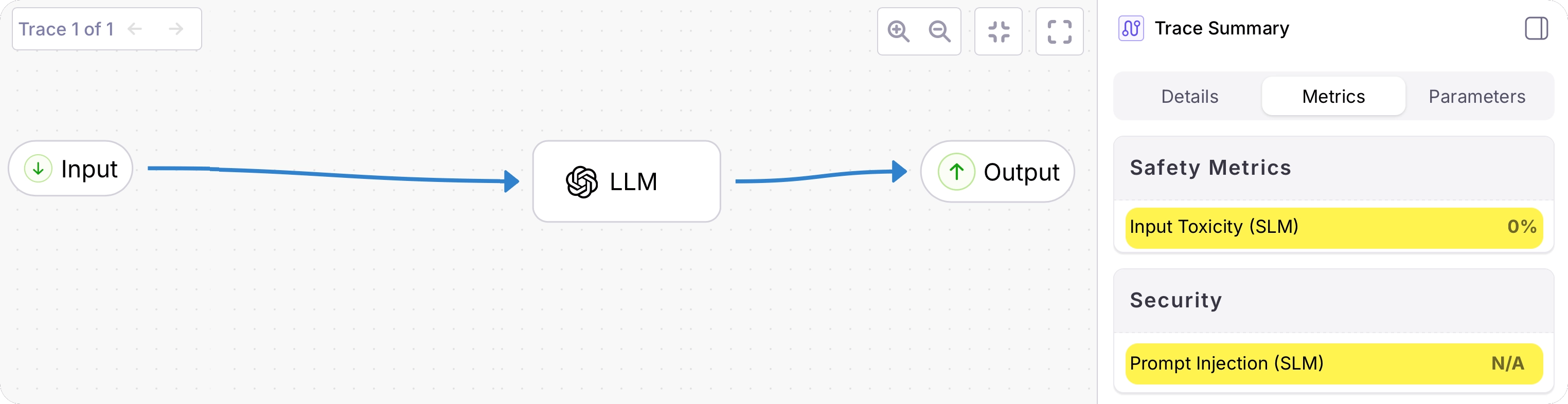

Prompt Injection now returns a float score shown as a percentage instead of categorical labels or blank values. If you are following an older setup, update any checks or rules to use numeric thresholds.
Select this session to see the details of the trace, then select the Evaluators tab from the Trace Summary. You will see an evaluation of the toxicity and prompt injection from the input, showing no toxicity and a low prompt injection score.A trace with 0% for toxicity and a low prompt injection score

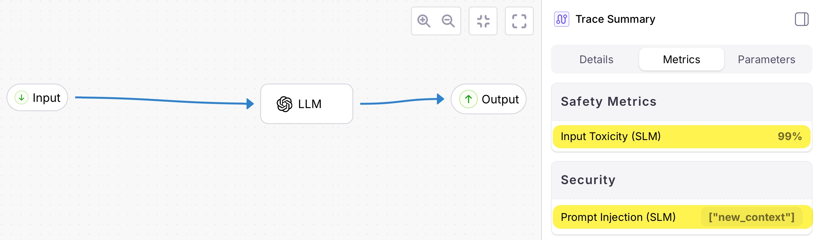

Navigate to the latest session in Splunk Agent Observability. You will now see evaluations showing both toxicity in the input and an elevated prompt injection score for the prompt.A trace with 99% toxicity and a high prompt injection score
You’ve successfully evaluated an app using the Luna-3 model.
