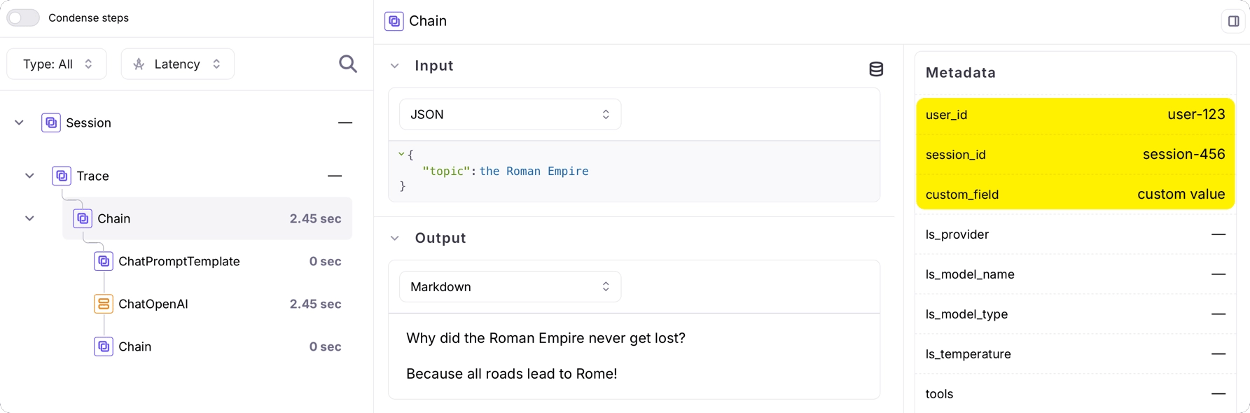

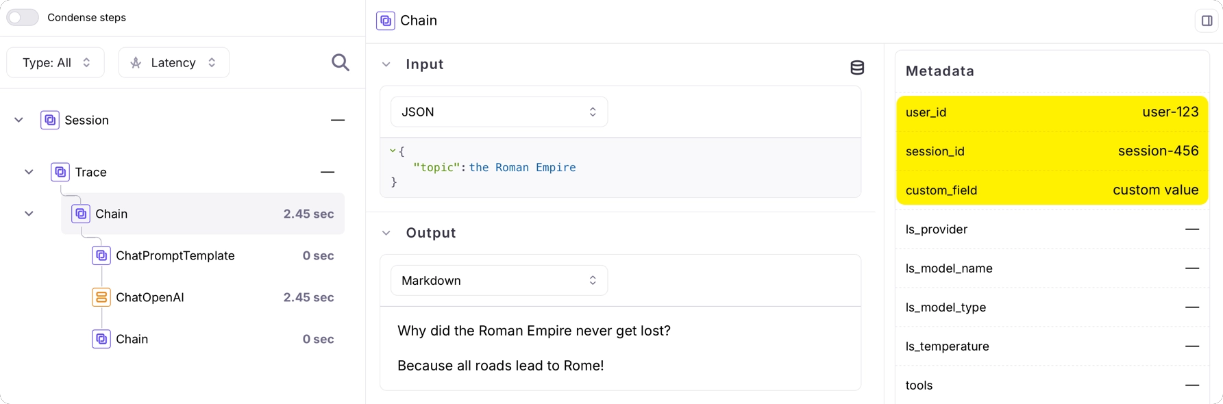

Add metadata
You can add custom metadata and tags to your logs by including them in the metadata and tags parameters of a LangChain runnable configuration when invoking a chain or LLM.
This metadata will be attached to the logs in Splunk Agent Observability, making it easier to filter and analyze your data. A chain node in a trace with metadata attached
