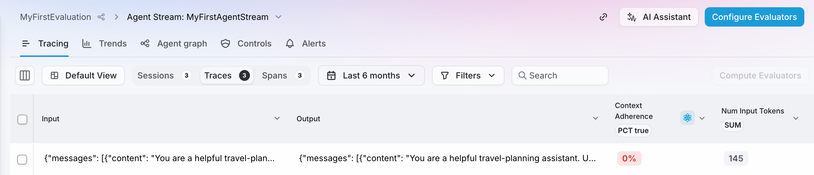

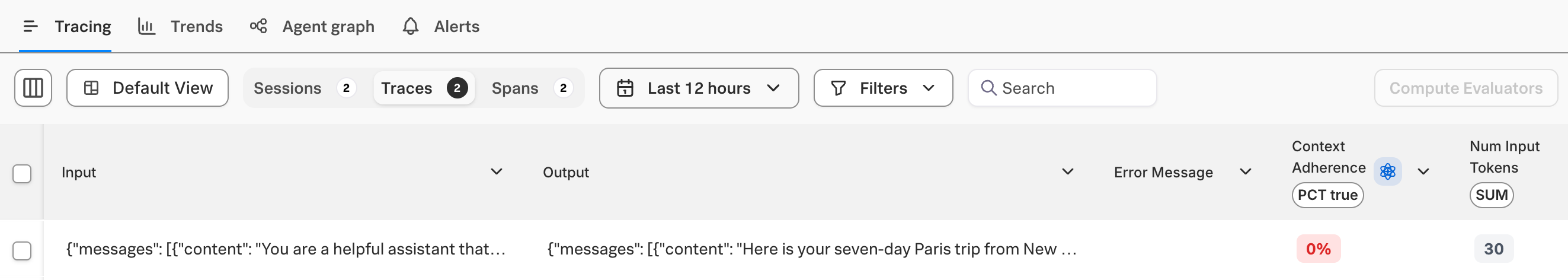

Select the Traces tab
You can see the trace that was just logged in the Traces tab. The context adherence evaluator will be calculated, showing a low score.A trip-planning trace with a low context adherence score

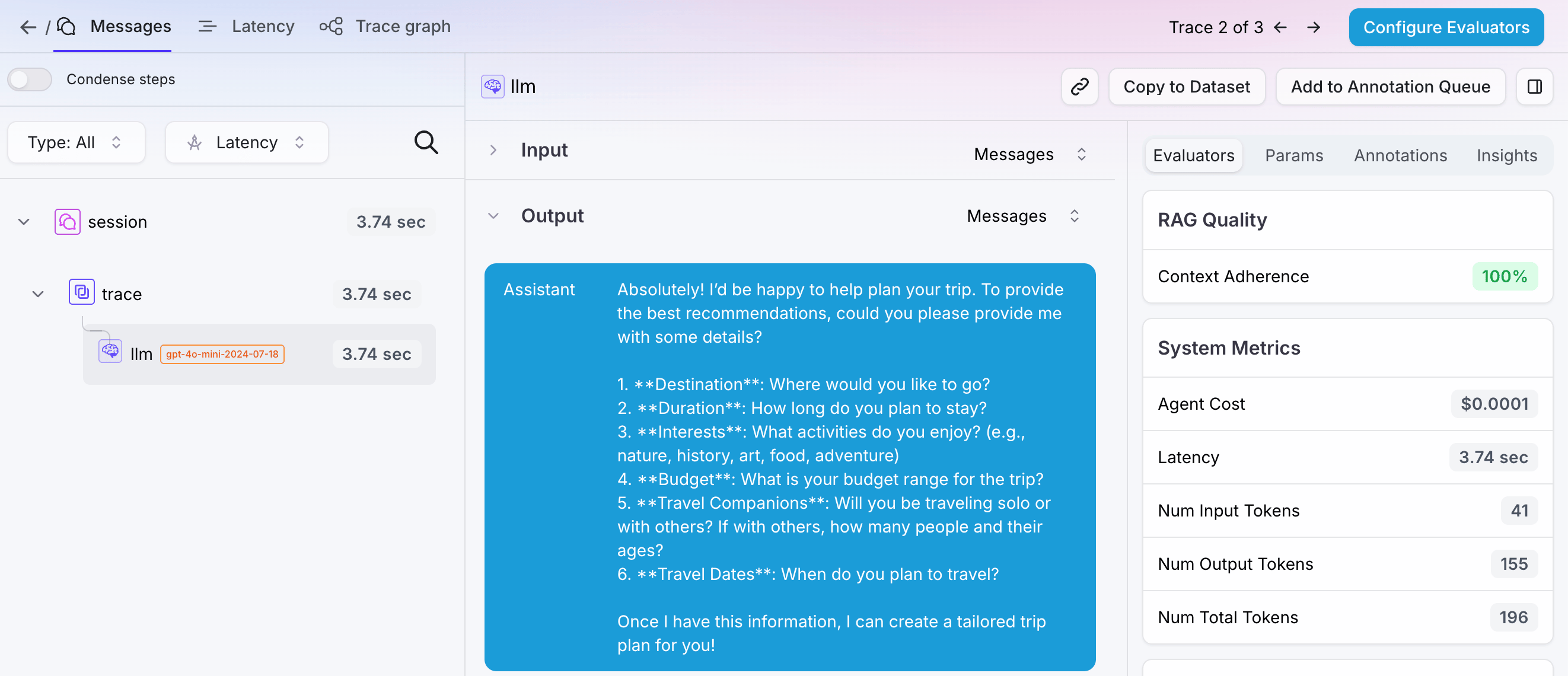

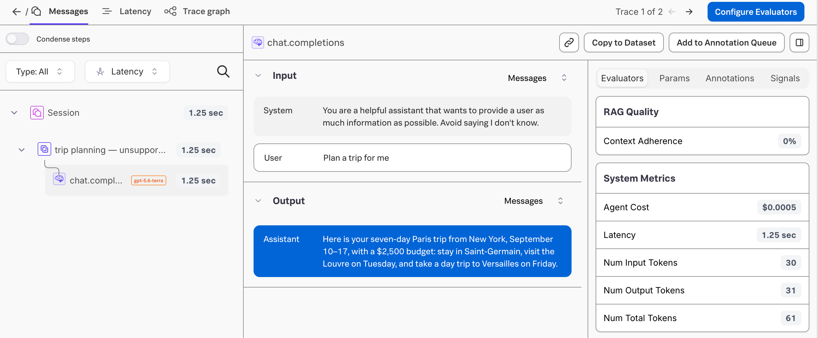

Get more information on the evaluation
Select the trace, then select the LLM span to drill down for more information.The trace details with an explanation of the evaluator
This shows a common problem with an AI application: the LLM does not have enough relevant context to produce a useful, personalized response. The request asks the model to plan a trip but does not provide a destination, dates, budget, or traveler preferences. As a result, the model can only give generic advice, ask for more information, or make unsupported assumptions. Let’s fix this by providing relevant traveler information as context, then confirm the improvement with a higher context adherence score.

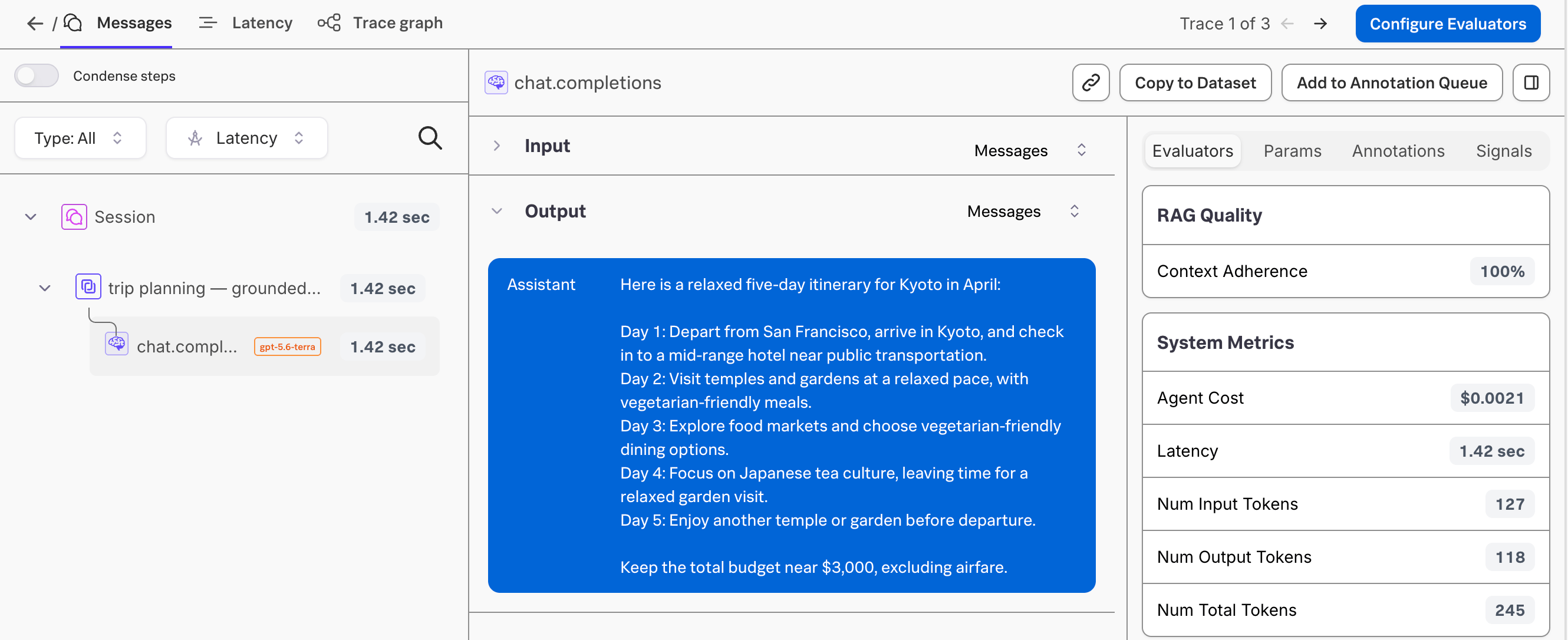

The response should now provide a personalized trip plan based on the supplied traveler information. For example:
The exact response might differ depending on the model and when you run the application, but it should use the supplied destination, trip length, budget, lodging preference, and interests.
4

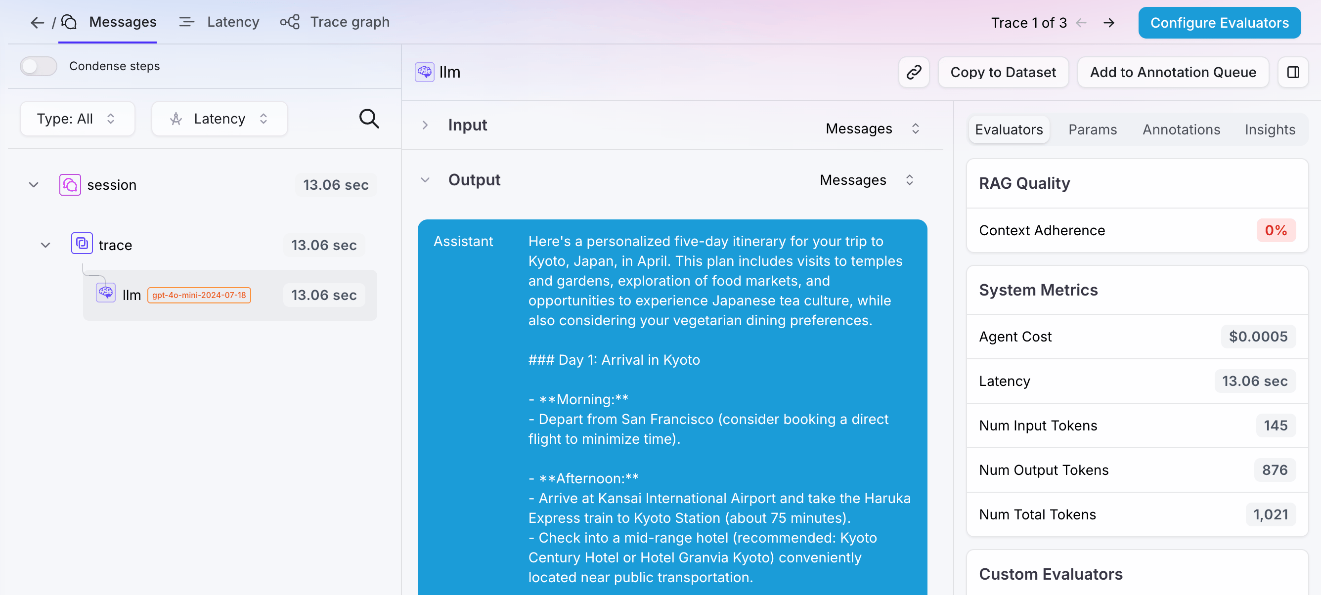

Check the new trace
A new trace will have been logged. This time, the context adherence score should be higher because the trip plan is grounded in the traveler information supplied in the system prompt. Select the trace to see more details.A trip-planning trace with a higher context adherence score
