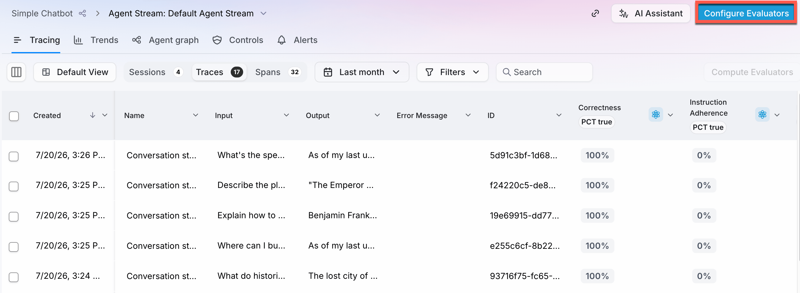

To configure evaluators, open your Agent Stream and select the Configure Evaluators button.
You will need at least one session in your Agent Stream to be able to configure evaluators.
The configure evaluators button on Agent Stream page This will load the Configure evaluators pane. From here, you can filter and search for evaluators, then turn on the relevant ones for your Agent Stream. Once you have the evaluators you need turned on, select the Save and close button to save your settings. You can also create new custom evaluators from this pane using a decision model, LLM-as-a-judge, or code, then add them to your Agent Stream.
