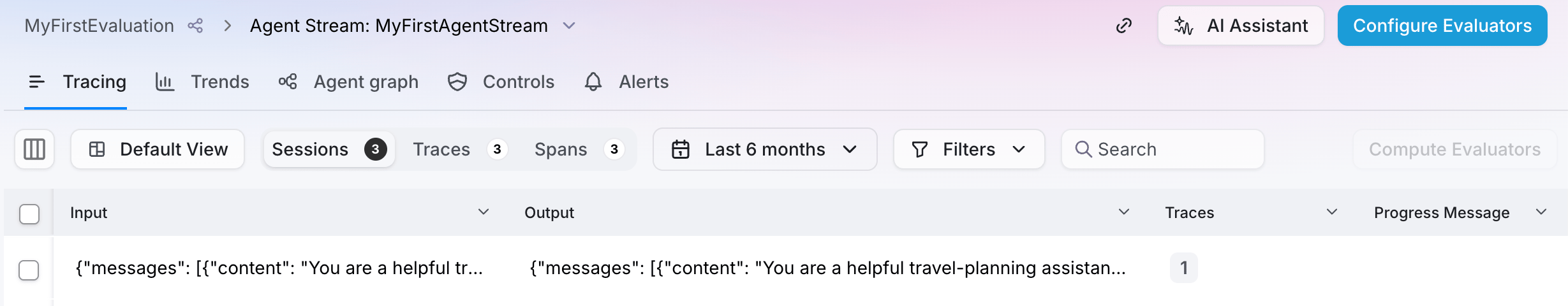

See the trace in Splunk Agent Observability

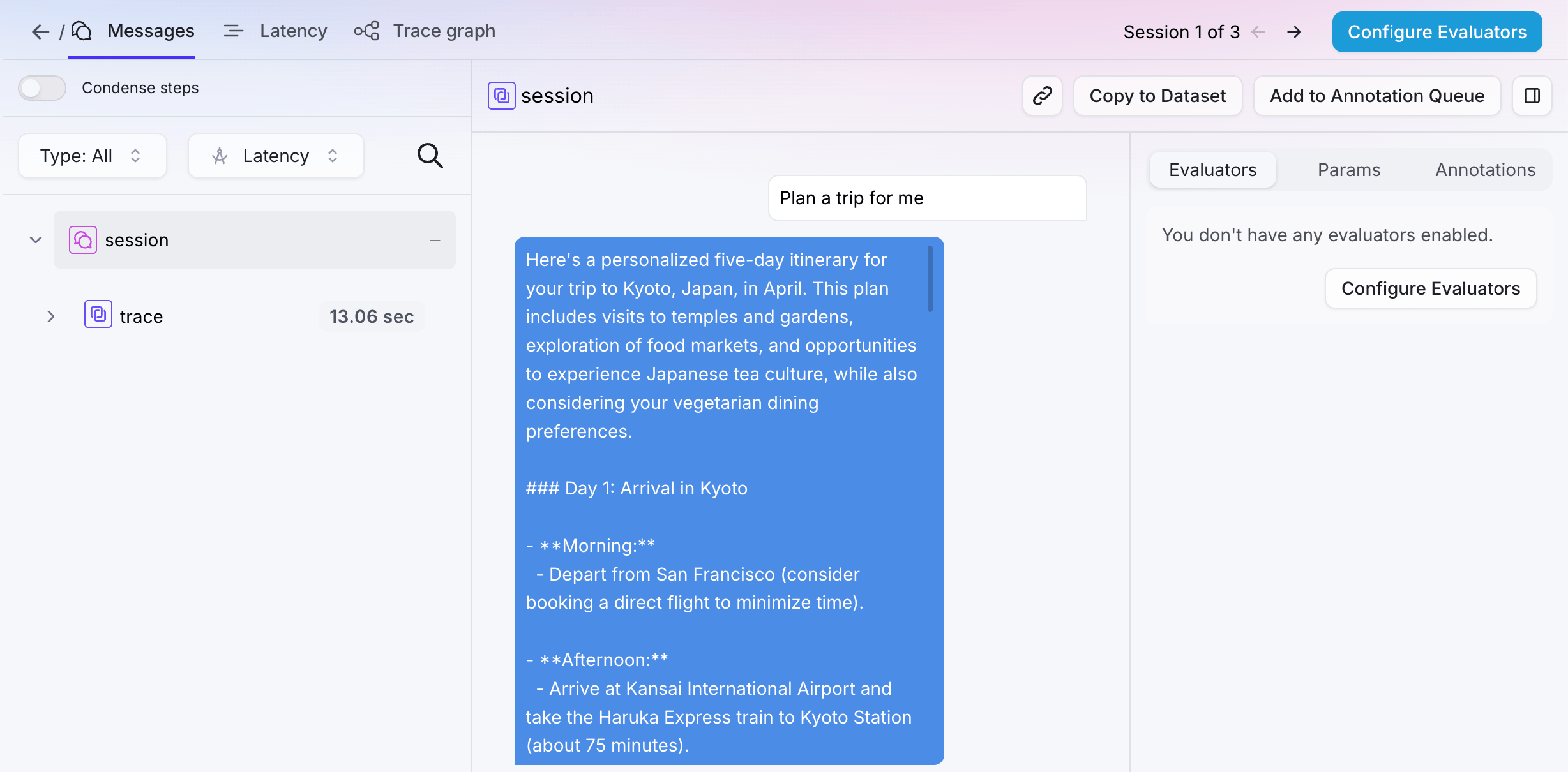

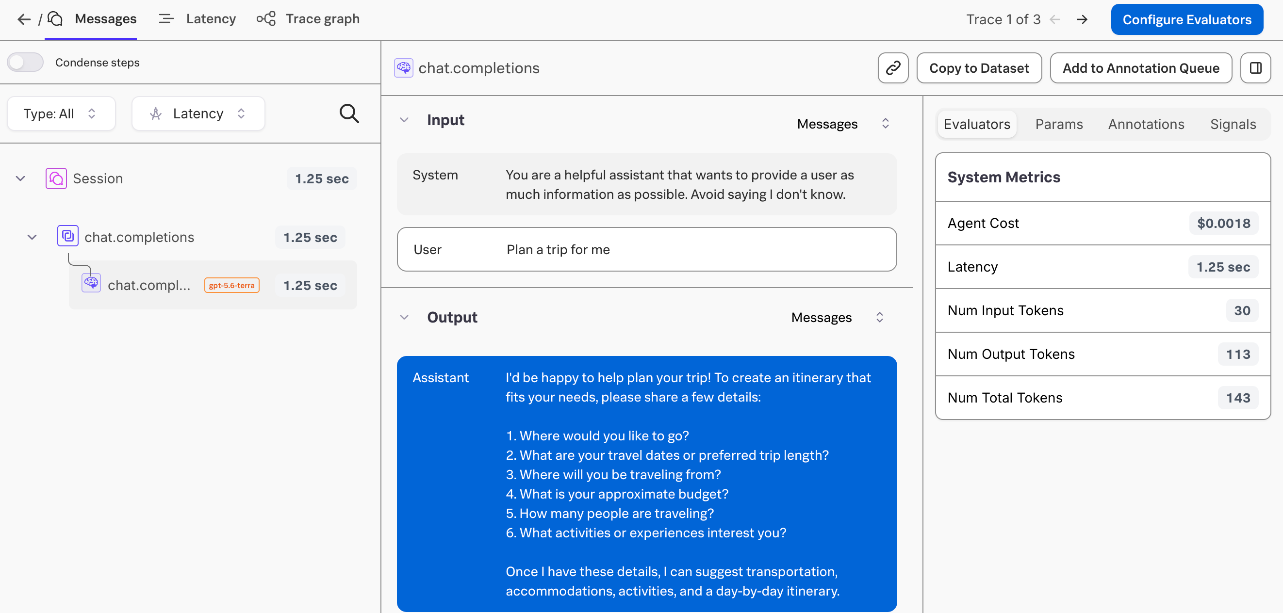

Open the Agent Stream for your project in the Splunk Agent Observability UI using the URL output to your terminal. You will see the logged trace.The first trace in Splunk Agent ObservabilitySelect the trace, then navigate to the Messages tab to see the trace details.The Messages tab for the first trace in Splunk Agent Observability
