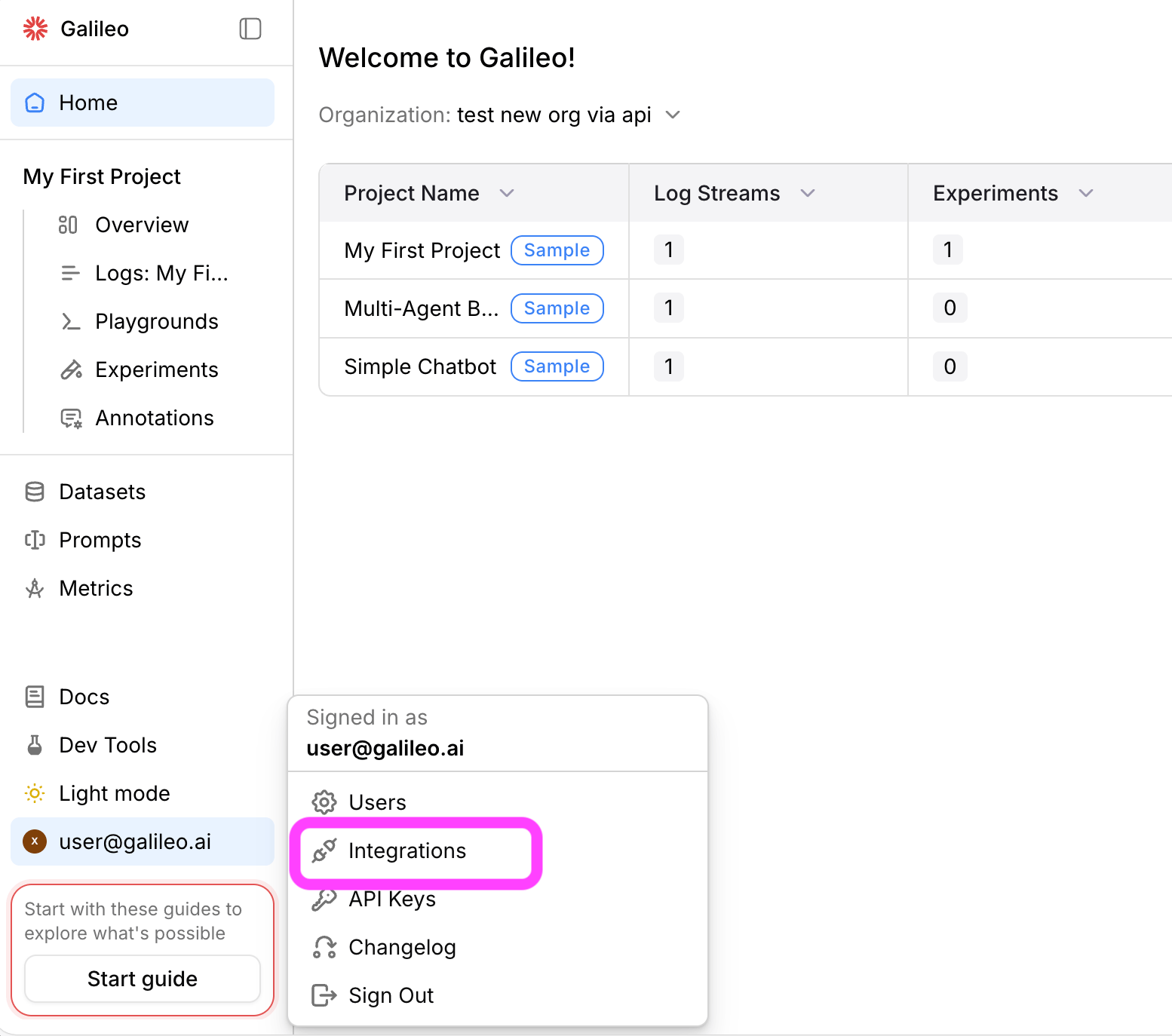

Navigate to LLM Integrations
To navigate to the LLM Integrations page, select your user profile in the upper-right corner and select Integrations from the menu.

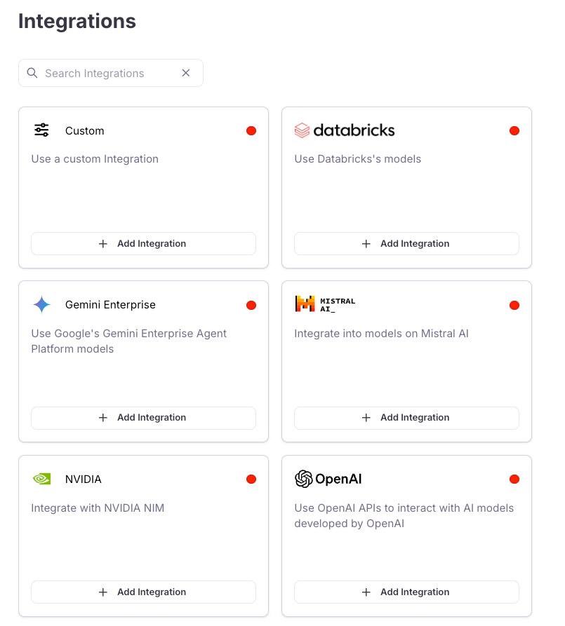

2
Add Gemini Enterprise
Locate Gemini Enterprise in the provider list and click + Add Integration.
