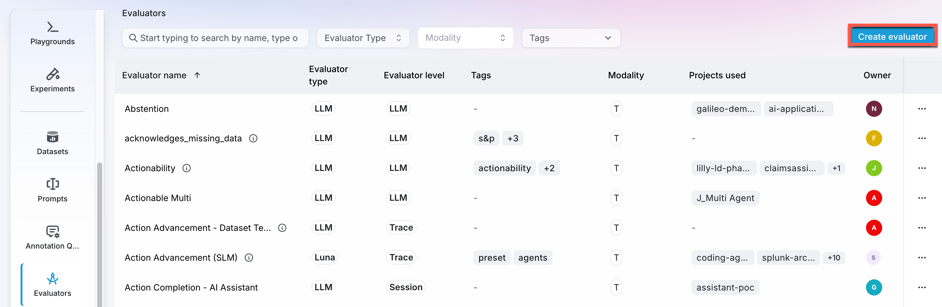

Navigate to the Evaluators section
Use the Splunk Agent Observability main menu to select Evaluators. Select the Create evaluator button.Create a new evaluator

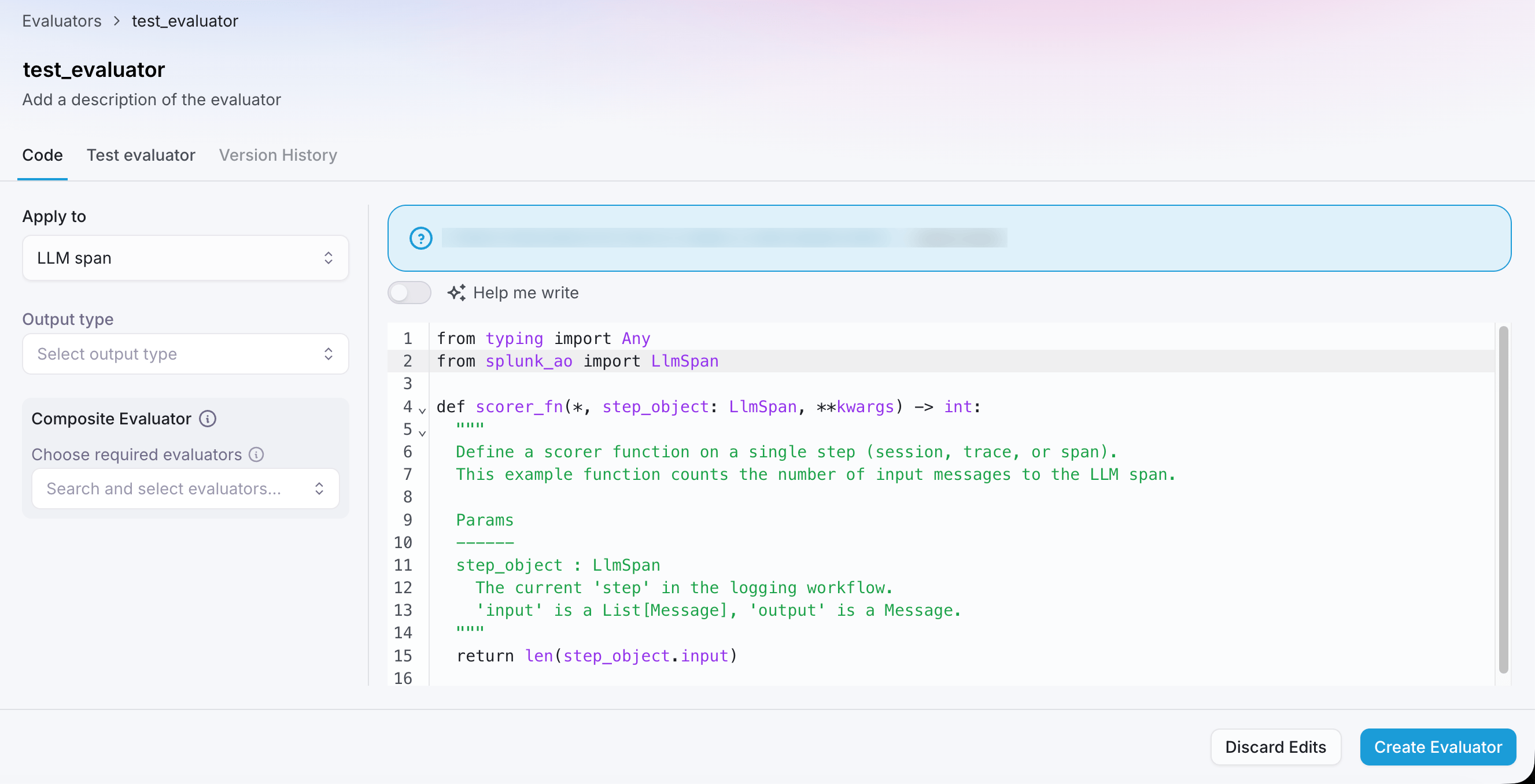

Write your custom evaluator
Select the step level you’d like to apply this evaluator to (ie: Sessions, Traces, LlmSpan, etc…). Then, use the code editor to write your custom evaluator. The editor provides a template with the required functions and helpful comments to guide you.Code editorThe code editor allows you to write and test your evaluator directly in the browser. You’ll need to define the scorer_fn function as described below.You can optionally enable the Help me write toggle to use AI-assisted code generation. See AI-assisted code generation for a full walkthrough of this feature.

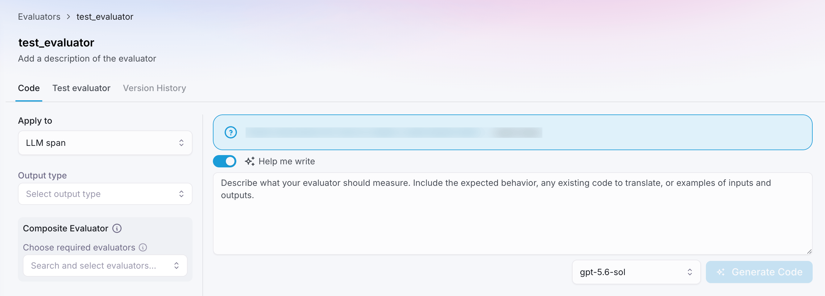

2
Enable Help me write
In the code editor, toggle on Help me write above the editor panel.
3
Describe your evaluator
In the prompt field, describe what you want the evaluator to do in natural language. Be as specific as you like — the more detail you provide, the better the generated code will match your intent. Optionally include examples of expected inputs and outputs for edge-case guidance.You can also paste in code from another evaluation framework (LangSmith, RAGAS, etc.) and the generator will convert it to a Splunk Agent Observability scorer automatically.AI-assisted code generation
4
Choose a model
Select the model you want to use for code generation from the dropdown menu. Models recommended for code generation are highlighted.
5
Click Generate Code
Click Generate Code. The scorer function is written directly into the editor. Review it, adjust if needed, and proceed to test and save as normal.

The scorer function
This function evaluates individual responses and returns a score:
The function must accept **kwargs to ensure forward/backward compatibility. Here’s a complete example that measures the difference in length between the output and ground truth:

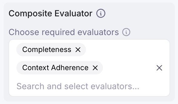

Composite evaluators are advanced custom evaluators that can access and leverage the results of other evaluators to perform sophisticated evaluations. This allows you to create conditional logic, aggregate multiple evaluators, or build hierarchical evaluations. To create a composite evaluator in the UI:
  1. When creating a code-based custom evaluator, use the Composite Evaluators section to select which evaluators must be computed before your composite evaluator runs Composite Evaluators section
  2. Access the required evaluator values in your scorer function via step_object.metrics
Example: Conditional evaluation based on other evaluators
Referencing evaluators
  • Splunk Agent Observability preset evaluators: Use the SplunkAOEvaluators enum (e.g., SplunkAOEvaluators.context_adherence)
  • Custom evaluators: Use the evaluator name as a string (e.g., step_object.metrics["My Custom Evaluator"])
Composite evaluators are only supported for code-based custom evaluators. For a comprehensive guide including use cases and best practices, see the Composite Evaluators documentation.
