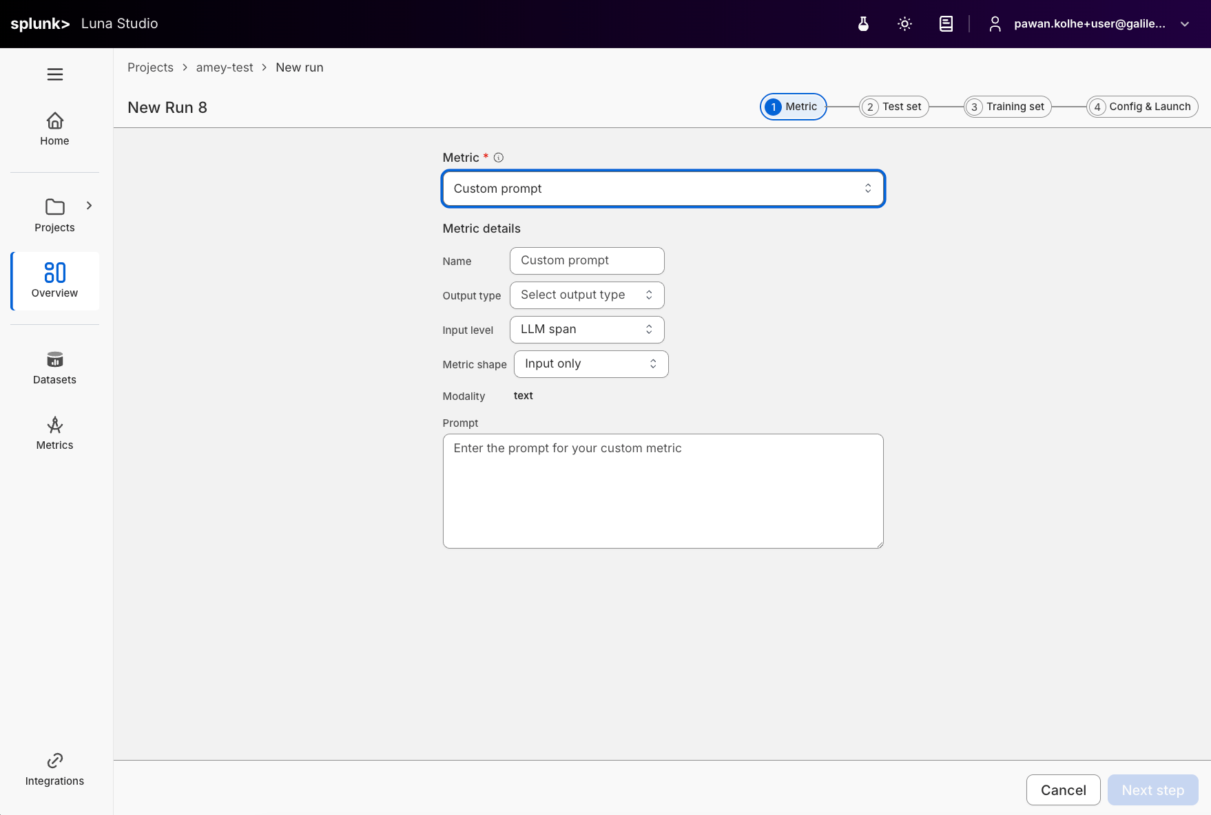

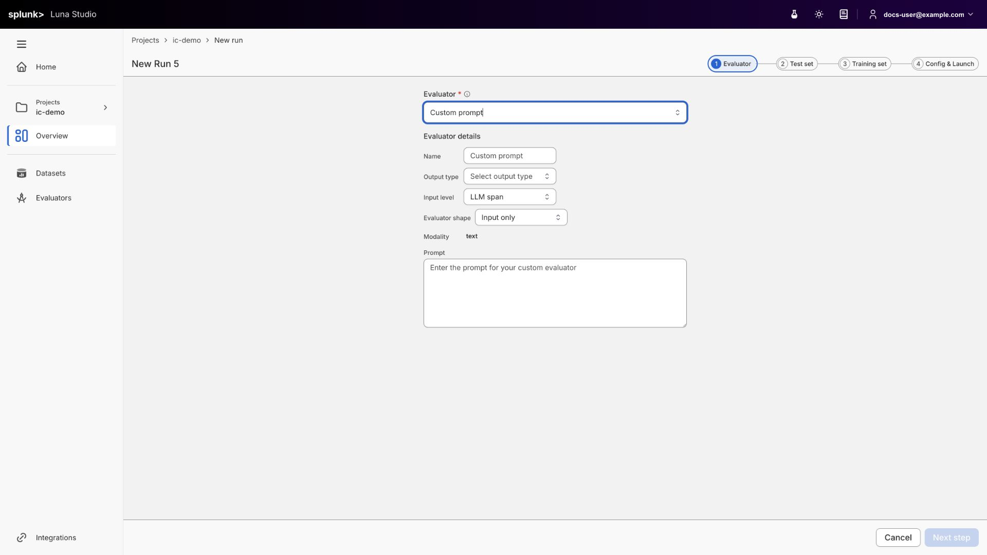

Custom evaluator in the run creation flow
Custom evaluator, run creation flow — Evaluator step with Custom prompt selected
Open custom prompt mode
From Step 1 of the run creation flow, open the evaluator dropdown and click Use custom prompt.
